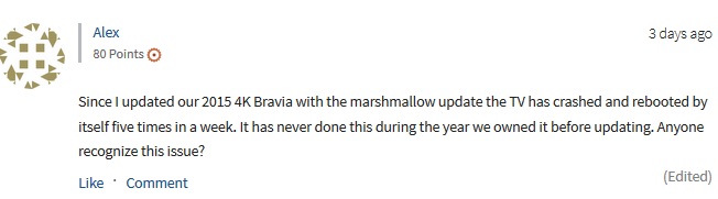

Linking to a post by 'Alex' on the YouView forums: HERE
