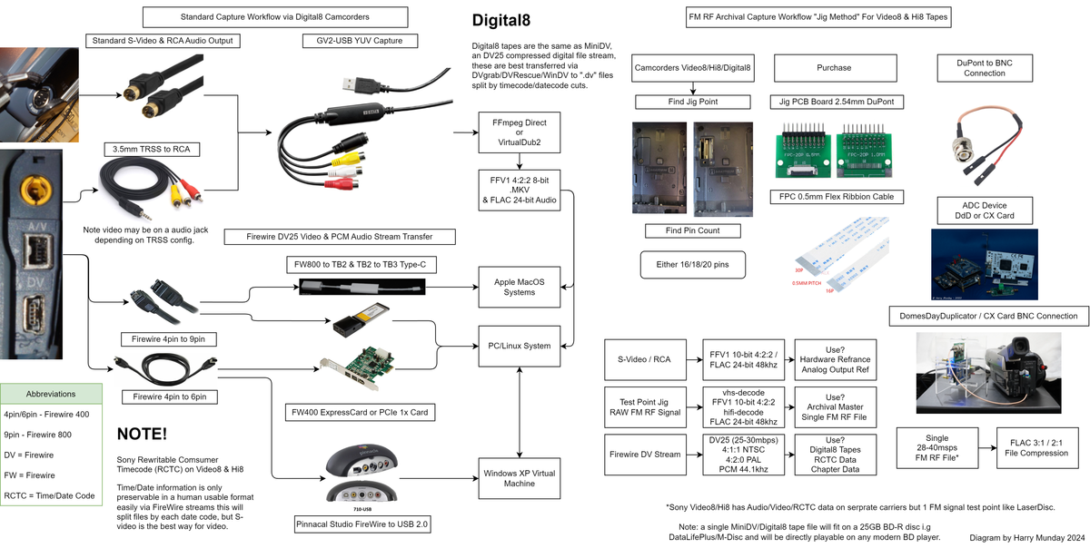

The final methods to tansfer video8 and hi8 are as follows.
Overview 8mm Diagram

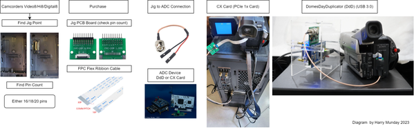

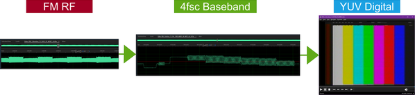

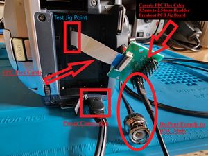

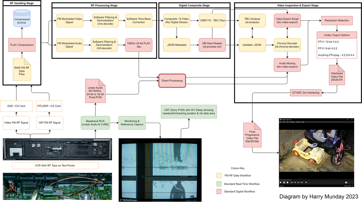

FM RF Archival --> Jig port from camcorder or 2.54mm headder on decks --> Single ADC --> FM RF file compressed in FLAC this preserves the orginal tapes signals in there native from in the analog domain, sampled like PCM audio but in Mhz range not Khz.
hifi-decode for HiFi FM audio and vhs-decode which does software time base correction and conversion to YUV seprately this is the modern archive standard for 8mm/Betamax/Umatic and VHS all of the colour-under tape family are supported and formats like SMPTE-C are also supported and more.
Jig RF Tap
S-Video from a later Hi8 or Digital8 with analog playback support --> YUV 4:2:2 8-bit or 10-bit via Analog to SDI or GV-USB2 unit for example then simply FFV1 and FLAC compress in the MKV container.
FireWire or DV25 using Digital8 camcorders and decks, this should only be used for Hi8 tapes with RCTC and or PCM audio this is not a fully quality of media transfer method for analog tapes very much so with NTSC 4:1:1 8-bit sampling and will have compression artifact issues when deinterlacing with QTGMC for example (which can be used in StaxRip or Hybrid with ease today)
For proper archival capture a combination of FM RF and either DV25 and S-Video or both is recommended.
Sony 8mm tapes if stored right will have a very good signal to noise ratio, and if you have already used a poor qulality method and there is no tape damage its worth giving them a final archival run today.
Overview diagram for VCRs
