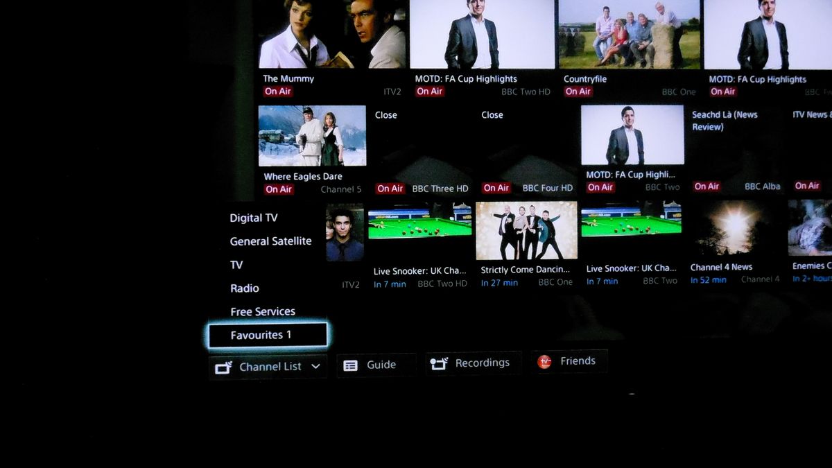

Hi,
I've been thinking about buying a w600 series tv. The reason for the w605 model is that it has both dvb-s2 and dvb-t tuners.
Some tv's require to change the input from dvb-s and dvb-t seperately, which is clunky.
Is it possible with the Sony to have channels from both of the tuners occupy the same "favorites" or similar channel lists?

Hi there
Q1 : Is it possible with the Sony to have channels from both of the tuners occupy the same "favorites" or similar channel lists?
I have tested this out on a 2014 4K TV, and can say YES.  You can add channels from both DVB-T and DVB-S tuners onto the favourites list.  You can access the favourites via the HOME Channels/Discover.  The channels are split/sorted via Digital (Terrestrial) and Satellite.
See photos:
