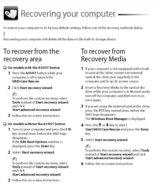

Does the following guide help.?

Hi and thanks for the help but I tried that and when I press f10 several times it says bootmgr is missing.
