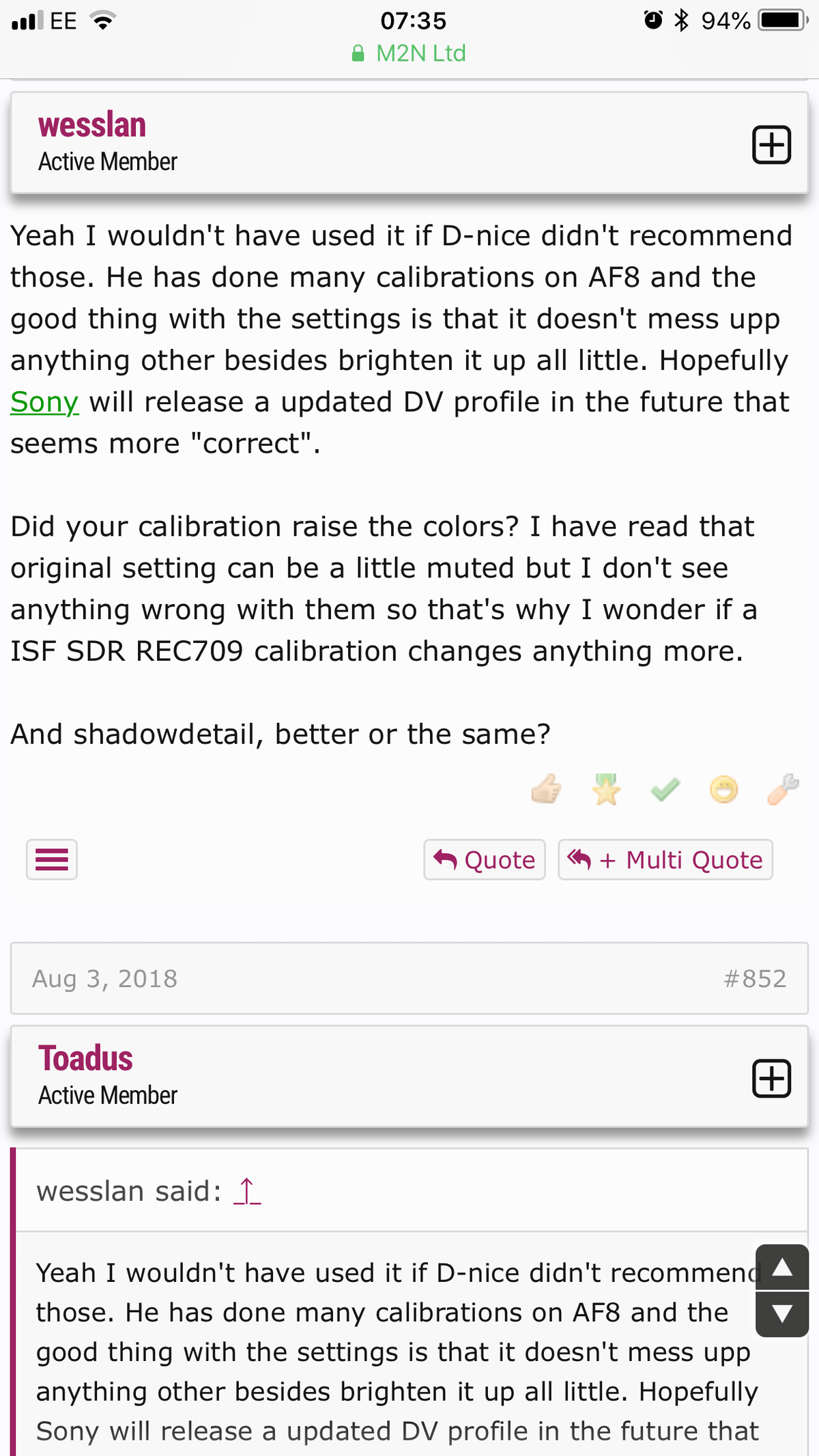

It happens with Dolby vision on Apple tv 4k too so its clearly a HDMI tone mapping problem as the problem is only there using external devices. Dolby Vision works fine on the TVs internal netflix app. This needs to be sorted.
There are others that are having this issue with this set too.
Forgot to ask, even though from reading your OP it sounds like you are not using any type of A/V receiver between your X700 and the TV. But are both your X700 and ATV directly hooked to HDMI 2 & 3 and Enhanced Format is enabled for the HDMI inputs? Do you have the problem also if you only connect the X700 and leave all other HDMI inputs free?
Final question out of curiosity, you mention other users are having this issue too, could you post the links to those posts so we can have a look and read them too?
