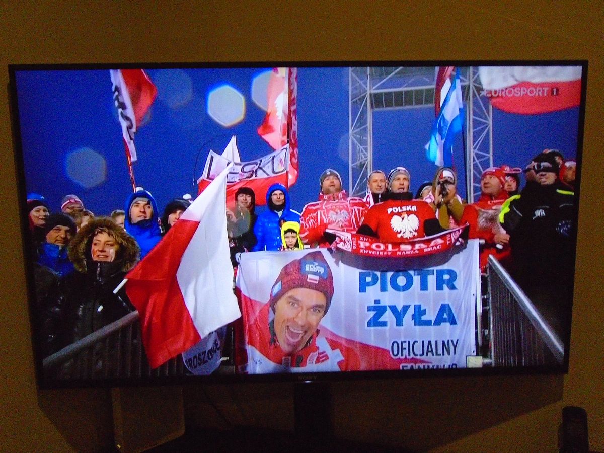

Hi,
I finally got around to taking some photos of some of my issues.
I am seeing lots of light reflections within the content and it's seems very excessive? picture quality is very poor also at times.
Flash in mid of screen is from my camera, ignore this. Blue shapes near station logo.
Octagon shapes appearing throughout screen.
Blue blur bottom left
lots of blur and streaks.

Nobody can say anything without knowing the source. I suppose the tv itsef cannot create octagone on the image i.e., nor the blur is always on the same part of the scene...
You should also let us know which setting are you using.
In order to attach the video you should upload to a site and share the link (i.e. youtube)

The source is a virgin media horizon set top box, and the tv settings are the factory defaults. I will try make video when i get some time over weekend.

The source is a brodcaster band you do not know  the qualità of them. Moreover factory settings means they are wrong....

it is not easy to understand what you mean being that the video are blurried by the camera focus and distortion... have you already tried resetting to factory setting the tv, so you can eliminate any glitch and/or wrong setting you may have applied?

Yes reset t.v. to factory settings many times.
